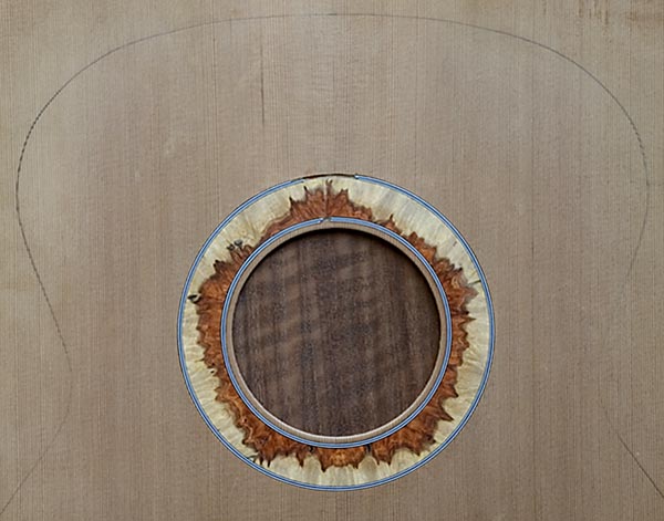

Question - This is my first time working with a cedar top.  Assuming it’s reasonably stiff, is it common to thin the edges a bit at the lower bout like many do with stiff spruce tops?

The way to treat cedar is how you would treat spruce, yes. Flex the top when thicknessing and check it's as flexible as you'd like. You'll find when you get it to the right point chances are it'll be thicker than a spruce top, as the wood's not quite as strong.
Shaving round the lower bout's also a great idea, I do it on every instrument.
Love that rosette by the way!

Very Nice!  I also like the rosette.

Just be careful when you're sanding around the edges... Cedar sands away LOTS faster you you are used to.
Ditto on the rosette... Looks like a solar eclipse. Gorgeous!

That looks great to me.  I see solar prominences in the rosette.  Really nice work.

I have to say that is one of the most interesting rosettes ever. Congrats on that.
Your claro walnut is really fine too.
This is going to be a great guitar.

Outstanding rosette!

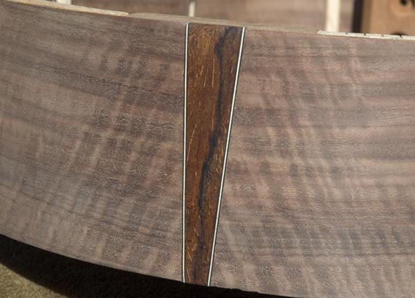

You have recieved excellent advice on the cedar top. Be careful and dont sand thru that rosette though!  Man I like that!!  Nice job on the end wedge too! very clean joint!

Good hearing from you again, Doug! Nice to have you back.
I love that rosette...details please

Nice rosette, what kind of wood is the rosette? That guitar is going to be a beeute.
